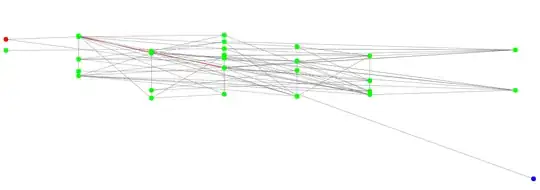

I've been working with neural networks and artificial intelligence for a while. What I'm trying to do right now is, from a genotype I have (a sum of sensors, neurons and actuators) draw how the neural network is (with recurrent/recursive connections being showed nicely, etc.)
What I have done now in javascript is this:
I know, its ugly
I have achieved this using SigmaJs, a Javascript drawing library, but I think it's still ugly, and what I'm looking for is a node drawing library that can achieve recursive connections in a nice way (right now, I'm drawing them with a red color as you can see on the image).
I have examined a lot of GitHub repositories and websites that can be helpful but aren't worth it since they aren't that nice.
Has anyone got an idea of what can I use, in javascript? If not, in any other language, how can I achieve what I want?
