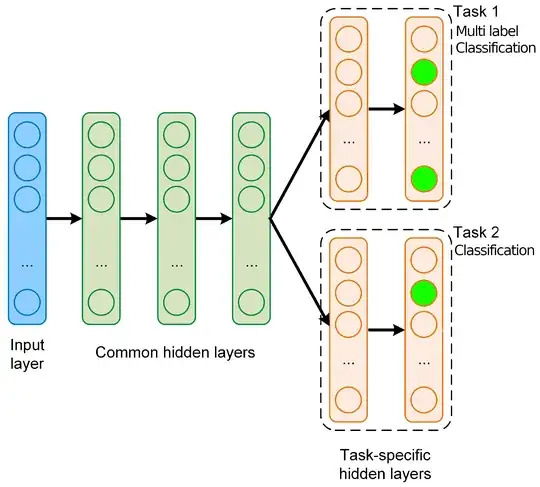

- Multi task means that we are learning more than a single task, i.e. the labels we have will be used to compute different losses
- Multi label means that for a single task, more than one label is allowed as correct prediction. but in practice, the different labels will be used to compute a single loss.
You can also visualize the difference: a network trained on multi tasks will have more output layers, one per task,whereas a network trained on multi label classification require only one output layer. Note that in a multi task learning setting one of the tasks could very well be multi label classification.
