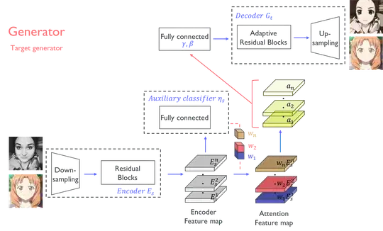

I wouldn't call it nor attention nor dynamic convolution.
Reason being that everything is static. if for conv(x) you refer to a standard convolution then that would imply a static kernel, so nothing fancy going on there but just a classic multichannel CNN, and adding 3 learnable parameters is basically just adding a linear layer (not dense) on top of those features. So in inference phase one of those parameters will be higher than the others and the features coming from the convolution, associated with that parameter, will overcome the others. Which doesn't really sound like attention.
The closest paper to what you're suggesting I can think about is: U-GAT-IT: Unsupervised generative attentional notworks with adaptive layer instance normalization for image-to-image translation.

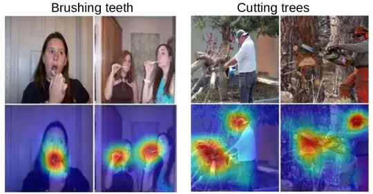

You can see in the image below that in their generator the authors apply individual weights to each feature map, but the crucial difference is that these weights are not just extra initialized parameters, they come from an auxiliary classifier trained precisely to generate attention masks, idea taken from Learning Deep Features for Discriminative Localization (from which I took the second image).

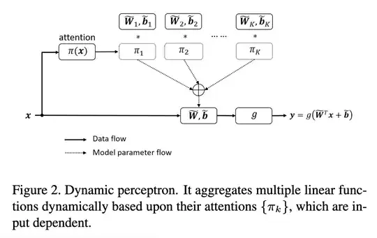

See Dynamic Convolution: Attention over Convolution Kernels by Yinpeng Chen et al.
The convolution kernels are generated by taking a weighted average of K=4 kernels. The weights are determined non-linearly via channel attention (i.e. "excitation" in SE networks) that uses global average pooling and a dense network.
Dynamic Convolution: Attention over Convolution Kernels - Figure 2
The paper also discusses some "training tricks", namely by limiting the space of possible weights via a softmax with "temperature" of T=30 to soften the max further.
See also: an implementation in PyTorch.
