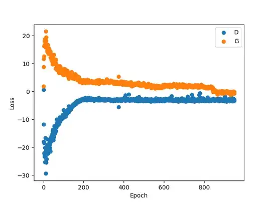

(Edit) Here is an image of the critic (D) vs generator (G) loss over the 900 epochs used to generate the fake data:
loss landscape of critic vs generator
