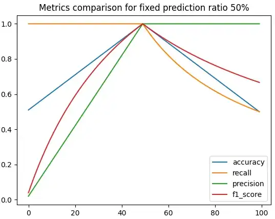

1. Yes, accuracy can be lower than the F score for a set of predictions and targets. You can easily test it by generating a fixed array of predictions and a varying array of labels (or vice versa). You'll get a graph like in the image below. Notice that you could obtain a horizontally mirrored version of the same graph by inverting the labels (or predictions).
To understand why you need to keep in mid that the F score is a skewed metric,because in its calculation we ignore an entire class, i.e. the true negatives.
$$F1= \frac{2 TP}{2TP + FP + FN} $$
So if I have an unbalanced dataset with only 10 instances of class A and 90 of class B I'll get an accuracy of 90% by predicting only B, with an f score of 0%, but if I invert the classes (i.e. predict only A) I'll get an accuracy of 10% and an F score of 18%.
2. The safer answer is always: check all metrics. Every metric tells you a different story about the model performance, so it's always a good practice to not rely only on one. But it might depends also on your specific use case. Why do you need to classify between low and high (whatever low and high refer to)? Do you care about a specific class? Then the recall is the most interesting metric to keep an eye on. In general, your problem is similar to probability thresholding when calculating the ROC-AUC score so you might want to check it out and see if it's applicable also to dataset splitting (a bit impractical if a single training session of your model is long though), if it's applicable, it's surely more reliable than the F score.
