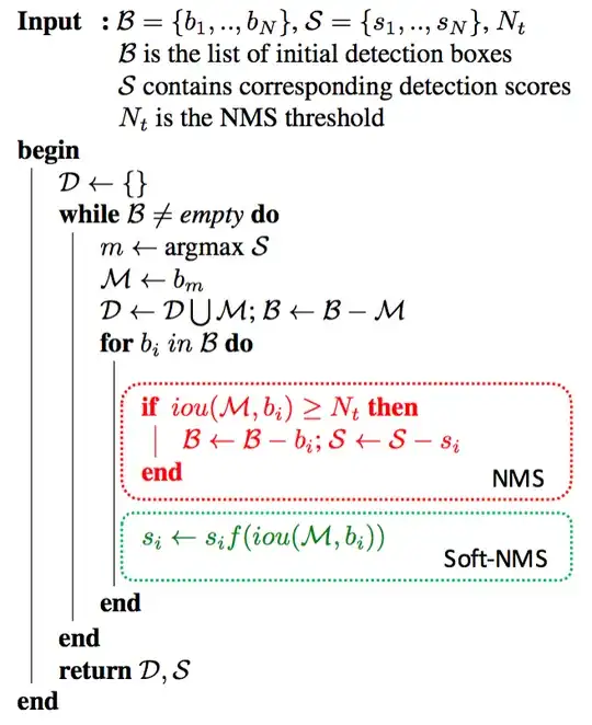

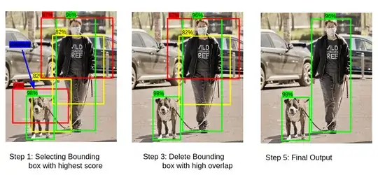

The picture below shows the algorithm (taken from the linked blog post).
You can see that Non-Max Suppression work iteratively, starting from the box with highest confidence score, and checking the IOU between it and the remaining boxes. In order to work, an initial threshold parameter needs to be set, this threshold is used to determine if one of the remaining boxes should be kept and tested in the next iteration or not. Basically we want to discard boxes that overlap too much. Conceptually, if I have a box with high confidence score in a location, and another box overlapping a lot with it but with a lower confidence score, I want to keep only the first one and discard the second. If instead two boxes are not overlapping, then they might be detecting different objects, and I want to keep both. Notice that in a soft version of Non-Max Suppression the IOU score is used to update the confidence scores of each box as well. After converging, Non-Max Suppression will return the set of best non overlapping boxes.
