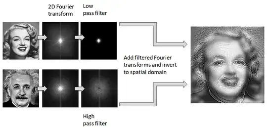

Moreover, when moving to the frequency domain, it become easier to access specific characteristics of images. Sharp lines and edges for example are characterized by high frequencies, so we can extract them with a simple masking operation, instead of having to came up with a tough kernel in the spatial space. This is the core idea of low and high pass filters, below here an example, where you can see that by masking the center (low frequencies) area of the spectra of two images, we can easily mix low frequency properties (e.g. shadows) and high frequency properties (e.g. edges) of two images. The same operation in the spatial domain would be tough if not impossible.

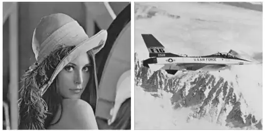

Consider two images, "Lenna" and "Airplane",
Take their Fourier transform, swap magnitudes and phases of their Fourier spectra, and then perform the inverse Fourier transform. The result is as follows.

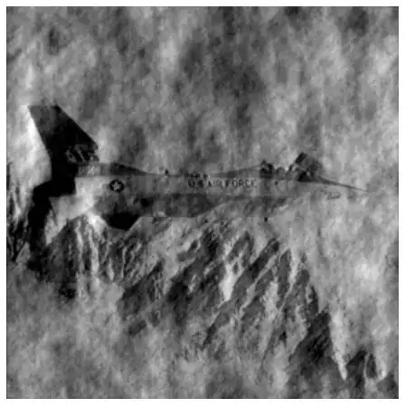

Magnitudes from the "Airplane", and phases from the "Lenna":

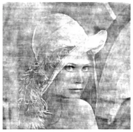

Magnitudes from the "Lenna", and phases from the "Airplane":
So, the information about objects is contained mainly in the phase part of the spectra.

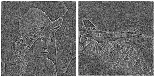

This is what happens when amplitudes are replaced by the constant 1:
This can be used to design algorithms for image processing.
