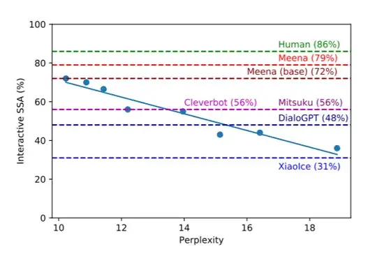

Google proposed a human evaluation metric called Sensibleness and Specificity Average (SSA) which combines two fundamental aspects of a humanlike chatbot: making sense and being specific. And they conducted some experiments and found that perplexity aligns very well with the SSA.
Here is the explanation in the paper:
Perplexity measures how well the model predicts the test set data; in other words, how accurately it anticipates what people will say next.
Our results indicate most of the variance in the human metrics can be explained by the test perplexity.
Their experiments showed a very strong correlation between SSA and perplexity(the lower the perplexity the higher the SSA). enter image description here
