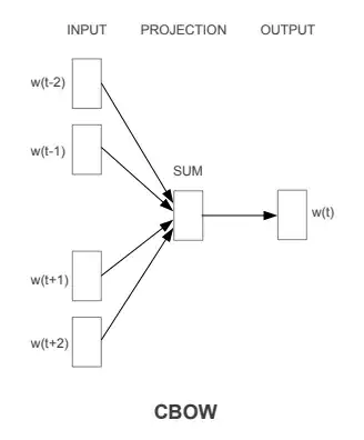

Embedding vectors also contain information about sequences. Mathematically they are derived from factorization of frequency (or co-occurrence) matrices, similar to TF-IDF, which are then compressed (with various dimensionality reduction techniques) to a set of vectors of fixed size. Of course the initial frequency matrix can be designed to encode a single word-pair probability per element, but nothing prevent us to make frequency matrices containing co-occurrence frequencies of triples or quadruplets (or more) of words. Some embedding are also trained using neural networks, most famous example being Word2Vec, more specifically the CBOW (Continuous Bag of Words) variation, a simple multi layer perceptron trained to project a word to a dense vector given a sequence of one hot encoded context words (see image below).
