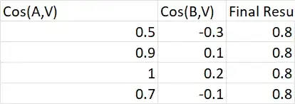

As the objective is to find the most similar to A and disimilar Vector to B approach 2 would be the most appropriate.
Why not Approach 1: It can lead to confusing results. If you look at the example below multiple scenarios lead to same final value. This may lead to few problems :
  1. For same output how do you know which vector should be preferred
  2. Subtracting with each other may cancel out impact of dissimilarity on one with other
Why not Approach 3: Vector Subtraction is not commutative. So you will get different results based on whether you use A first or B first. Moreover lets see an example where it fails completely :
