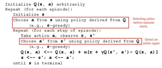

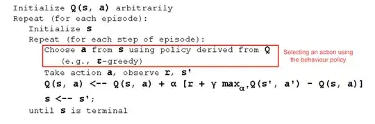

Here's the pseudocode of Q-learning.
Here's the pseudocode of SARSA.
So, as you can see, in SARSA, we choose one action before the episode starts, and, during the episode, we choose (and take) again more actions. In both cases, we choose these actions with the same policy (e.g. $\epsilon$-greedy), which is derived from $Q$. In Q-learning, we do not choose an action before the episode starts. We only choose and take an action at each step of the episode (like in SARSA). Hence, in SARSA, we choose actions in two places (but only take an action at each step of the episode). Note the difference between choosing/selecting an action and taking an action in the environment (you may just choose an action to update the Q-function, i.e. without taking it into the environment!).
