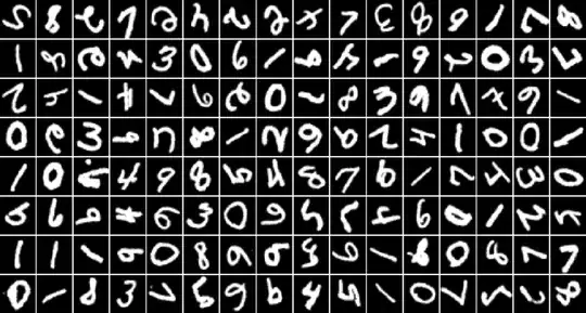

Rotated MNIST is a popular dataset for benchmarking models equivariant to rotations on $\mathbb{R}^2$, described by $SO(2)$ group or its discrete subgroups like $\mathbb{Z}^{n}$:
It consists of all digits from 0 to 9 rotated on an arbitrary angle from $[0, 2 \pi)$. However, what makes me a bit puzzled is that digits $6$ and $9$ seem to be confused by any learning algorithms, since from the view of human perception $6$ rotated by 180 degrees is equivalent to $9$ and vice versa.

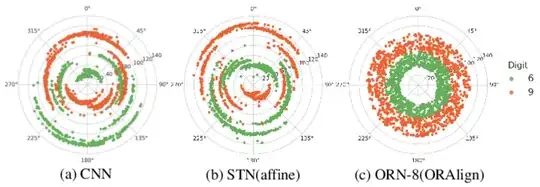

In the paper Oriented Response Networks - authors plot embeddings of rotated digits projected via t-SNE on a 2d plane. There is a clear separation between all rotated versions of 6 and the rotated version of 9 for ORN.
I do not understand how it can be achieved? Probably, the networks understand much more in writing the digit, there are some subtle features, inaccessible to humans, but recognizable by powerful classifier?

I think by writing left to right people create clockwise and counterclockwise patterns in the rounded parts of their typography.
For example, I think it'd be pretty unusual to write a 9 like this --> digit example from OP image
I bet you could also detect the original orientation of the 8s if you wanted. The circle that isn't continuous/smooth is most likely at the top.

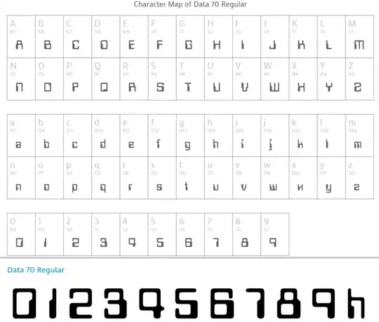

With a 9-pin Dot Matrix Printer all bets are off, since the usual font was not designed to differentiate between rotated characters.
Dot Matrix Printer font
If anything, the fontographer cheated and rotated the characters whenever possible to avoid the effort of creating a new character from scratch.
Later fonts such as Data-70 were able to avoid rotation ambiguities at the cost of readability, and increased geekiness.
Data 70 Font
