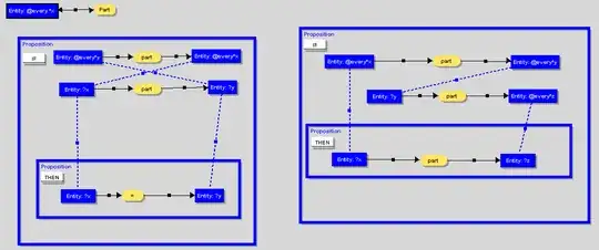

Below is my naïve attempt to present the axioms as a set of conceptual graphs (CG). My motivation for using CGs is that they provide an intuitive visualization of logic and have a direct relation to Common Logic (ISO zipped PDF).
The above CG was produced using CharGer software as Java zip file (manual).
My understanding of the above CGs is as follows:
  1. The variables are universally quantified, not default for CGs, but allowed in extended CG (ECG).
  2. The three graphs are all related by conjunction, which is default for GC.
  3. The arrow on graph representing reflexivity is bi-directional.
  4. Both antisymmetry and transitivity are represented by an IF-THEN contexts.
  5. Dotted lines are co-references.
  6. Equality (=) is actually commutative, but is represented as a directed relation .
  7. Each CG asserts a single proposition, labelled Proposition.
Question:
How do I present Theory 1 using CGs? Do I need some labeling that indicates that a set of concepts represent a theory. Or are theories represented by some enclosing special type of concept?
