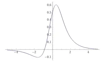

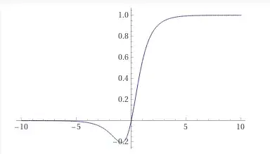

My intuition was based on the flow of tanh(x)*sigmoid(x)
tanh(x)*sigmoid(x)
and the derivative of tanh(x)*sigmoid(x)
(tanh(x)*sigmoid(x)')
It seems to me that authors wanted to choose such a combination of functions, the derivative would make possible big changes around the 0, since we can use normalized data and weights. Another thing is that the output would go to 1 for positive values and go to 0 for negative values which is convenient.

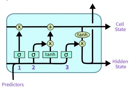

The tanh functions within the cell represent cell output or cell state. These are the values that either get passed on to other layers, or within the layer to the next time step. In theory, other activation functions could be used here according to taste, similar to other feed-forward or RNN networks. However, the -1 to 1 output range of tanh is useful, and I expect tanh has been experimentally validated as a good general case activation function here.
The sigmoid functions are used as soft gates for manipulating the raw RNN values. Importantly for your analysis, there is no sigmoid that takes the same input as any tanh. Each of the green boxes in the cell diagram in your question has a separate learnable set of weights applied to the combined input+hidden_state vector.
That means that your analysis of tanh(x)*sigmoid(x) is moot. The function is effectively tanh(x)*sigmoid(y) because inputs to each activation function can be radically different.
The intuition is that the LSTM can learn relatively "hard" switches to classify when the sigmoid function should be 0 or 1 (depending on the gate function and input data). As the weights are independent on the gates and input value processing components, the gradients to the cell output and state components are not composed in a combined function, but simply multiplied by the current value of the relevant switch. A muliplying hard switch of 1 will allow the gradient to flow back directly from the output loss to the point at which the gate decision was made - depending on which gate was activated, this improved gradient signal will either be to the input processing weights or the hidden state procesing weights.
It is also possible for the input and cell state processing to be mixed in various combinations, and the gradient is not guaranteed strong. However, in situations requiring strong memory-like signals (such as using punctuation characters when processing text), it is possible to observe LSTM learning those signals, effectively classifying inputs with high confidence (close to either 0 or 1), thus creating toggle switches, counters etc, within the cell state vector.

I think a better way to understand LSTMs is by their purpose, instead of gradients and distributions.
If you analyze the interactions of each gate with the cell state, you'll realize that LSTMs essentially implement differentiable memory as a counter.
There are 2 important things to realize:
  • Each sigmoid/tanh is preceded by a linear projection, so the output of the sigmoid of the forget gate is different to that of the input gate.
  • Sigmoid outputs are mostly 0 or 1, while tanh outputs are mostly -1 or 1.
Following the numbering in the diagram:
  1. The forget gate generates a binary mask which is multiplied with the previous cell state. Items with 0 in the mask are 'reset' to 0, while items with 1 in the mask are passed through unchanged.
  2. The input gate generates 2 masks using sigmoid and tanh, whose product is added to the cell state. The tanh mask with, -1 or +1 outputs, determines whether to decrement or increment items in the cell state. The sigmoid mask determines whether an item should be updated at all, similarly to the forget gate.
  3. The output gate determines what to expose to the subsequent layer and state using a similar logic. The tanh here acts as a 'binarizer' to simplify the cell state (which can theoretically be from -infinity to +infinity) to a binary -1 or +1 value, while the sigmoid masks out irrelevant items.
So while you could replace sigmoid and tanh with other activation functions, they make the most sense in this context and have the added benefit of well-defined derivatives. Remember that LSTM's were introduced in 1997 when tanh and sigmoid activation functions were still popular, and ReLU had not taken over yet (~2011).
