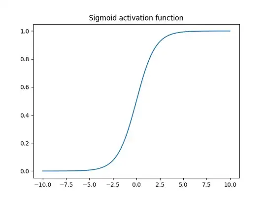

An activation I'm sure almost anyone is familiar with, the sigmoid function:
$$f(x)=\frac{1}{1+e^{-x}}$$ Which looks like:enter image description here
If we use the sigmoid function as the activation of all neurons (without bias'), if a value needs to be shifted, we can never do this directly. Instead, it can only ever be scaled in such a way that it shifts on the next layer when we multiply by more weights and add. That might be a little confusing, so imagine it like this:
If you had a desired output of 2, how would you ever reach that with the sigmoid function? The answer is you can't, and that's where a bias comes in. With a bias of 1.5 and an output of 0.5, you could reach your desired output of 2.

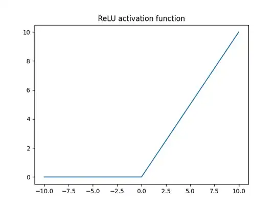

For an even more concrete example, let's take a look at the Rectified Linear Unit (ReLU):
$$ f(x) = max(0, x)$$
Which looks like:

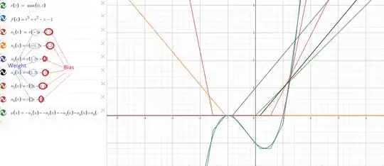

Now the goal of a neural network is to approximate a function, so lets in this case try and approximate a 2d function using the ReLU activation function. Conveniently, there's a really nice example in desmos of exactly this. As you can see, each ReLU equation employs a bias to move the function around. I challenge you to try and fit $f\left(x\right)=x^{3}+x^{2}-x-1$ without using a bias, and you'll really quickly see the need for a bias:
*Note I should've included the sign along with the numeric value of each bias inside the red bubble below enter image description here

An important distinction to make is this - An output of 0 is perfectly normal in a neural network. As an example, look at ReLU! A proven, extremely effective activation function that for half of all inputs, outputs a 0!
