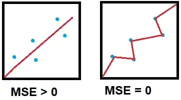

I want to calculate an upper bound on how many training points an MLP regressor can fit with ~0 error. I don't care about the test error, I want to overfit as much as possible the (few) training points.
For example, for linear regression, it's impossible to achieve 0 MSE if the points don't lie on a line. An MLP, however, can overfit and include these points in the prediction.
So, my question is: given an MLP and its parameter, how can I calculate an upper bound on how many points it can exactly fit?
