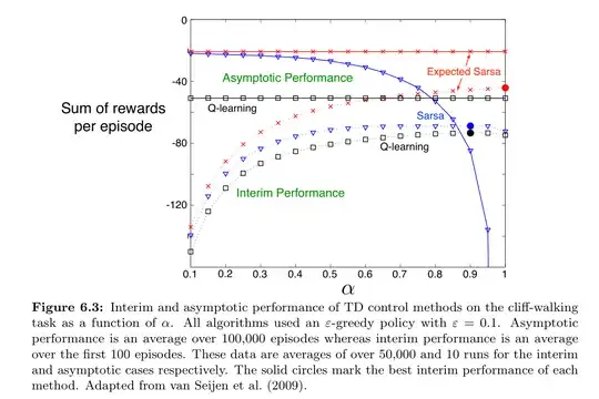

In figure 6.3 (shown below) from Reinforcement Learning: An Introduction (second edition) by Sutton and Barto, SARSA is shown to perform worse asymptotically (after 100k episodes) than in the interim (after 100 episodes) for larger values of alpha (alpha > 0.9). The graph is for the cliff walking gridworld example whose description is also given (from the paper by van Seijen et al).
Cliff Walking
Figure 6.3 Sutton and Barto (second edition)

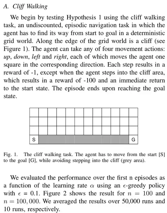

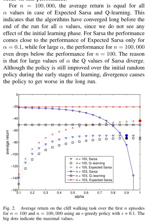

As the image mentions, the image is taken from a paper by van Seijen and others titled "A Theoretical and Empirical Analysis of Expected Sarsa". In the image below from the van Seijen paper from Section VII A Discussion, the authors mention that the reason for the better interim performance of SARSA as compared to its asymptotic performance for larger values of alpha, is the divergence of Q-values. The authors, however, fail to mention the reason for the divergence.
van Seijen et al's explanantion
What would be the reason that SARSA diverges but not Expected SARSA or Q-learning?

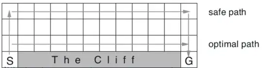

I think a useful piece of information to answer this question is a representation of the safe and optimal policies that can be learned on the cliff grid world. SARSA learns the safe path while Q-learning (and on the long run also Expected SARSA) learns the optimal path. The reason lies in how the different algorithms select the next action.
