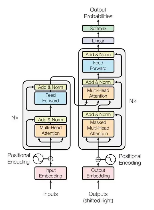

Note that the architecture of the encoder (and decoder) uses residual connections that add the original input to the output of the self attention layer. Thus, the information from the positional information will be preserved in the deeper layers.
The encoder also uses a position-wise mlp after the self-attention, after which we also apply the residual connection. For more details (and figures) on the encoder architecture see here.
