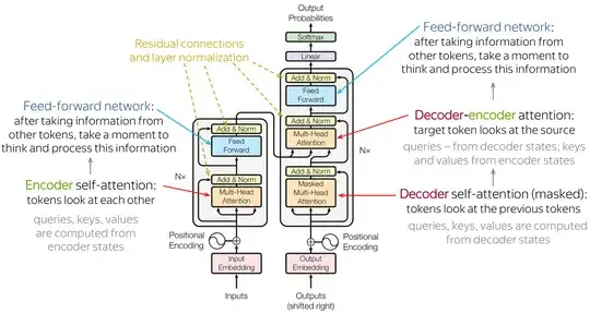

Feedforward layer is an important part of the transformer architecture.
Transformer architecture, in addition to the self-attention layer, that aggregates information from the whole sequence and transforms each token due to the attention scores from the queries and values has a feedforward layer, which is mostly a 2-layer MLP, that processes each token separately: $$ y = W_2 \sigma(W_1 x + b_1) + b_2 $$
Where $W_1, W_2$ are the weights, and $b_1, b_2$ - biases, $\sigma$ - is the nonlinearity ReLU, GeLU, e.t.c.
This is kind of a pointwise nonlinear transformation of the sequence.
I suspect, that intermediate here corresponds to $W_1, b_1$ and the output is about $W_2, b_2$.
