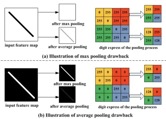

There are cases, where each of these operations may not be good for feature extracting (from here): enter image description here
In th first case Max Pooling will produce simply a white background, and in the second after Average pooling one will get a pale grey strip (although I think, it should be lighter, than depicted).
Probably It would make sense, to mix these two approaches, and pool half of the filters with Max Pooling, and another half with Average Pooling, although, I am not aware of the use of this approach in the literature.
