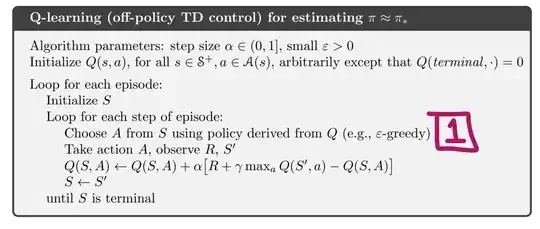

If you see in the Q learning algorithm, the e-greedy consist on selecting with a probability of $\epsilon$ $a \gets \text{any action}$, and with $1-\epsilon$ the $a \gets max_{a}Q(s,a)$. This $\text{any action}$ is the part of the code that you use this "controller" to only select random (but valid) actions. This is because you want to explore but only explore with valid actions. Then the Q learning can "exploit" picking the best action from the exploration you did before. Now, for your case with continuos actions, you can use DDPG/TD3 to do something similar but you store these valid actions in a replay buffer, so your Neural Network can learn for this "data" of only valid actions.
Q learning
