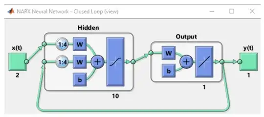

Closed Loop Network Step-Ahead Prediction Network
The function CLOSELOOP replaces the feedback input with a direct connection from the output layer. Step-Ahead Prediction Network also known as removedelay function helps to remove delay to neural network’s response
In Closed loop networks, its own predictions become the feedback inputs. targets with a delay were used as feedback input
Network used to do multi-step prediction Network used to predict one step ahead
Highly helpful to turn the network into parallel configuration Can't be used for parallel configuration
Output is not shifted one timestep the output is shifted one timestep.
Closed loop network continue to predict when external feedback is missing, by using internal feedback Open-loop and Remove-delay use external feedback
Real time Configuration Not real time configuration
Closed loop network will produce output for the time extent of the input. will produce output for the common time extent of the input and target.

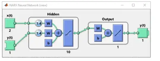

Open-Loop Network In open-loop networks, targets were used as feedback inputs. Open loops are primarily used when future outputs are not known. Below is how open loop network looks like Note:
The typical workflow is to fully create the network in open loop, and only when it has been trained (which includes validation and testing steps) it is transformed to closed loop for multistep-ahead prediction
Open loop network

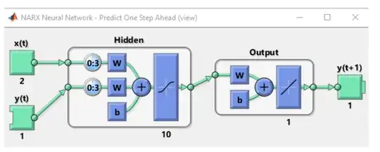

UPDATED Response to newly added questions
"The desired output, AKA the delayed target, is used as an additional input." how is this?
This is with reference to the Step-Ahead prediction network. Here, the delayed target is used as an additional input. Kindly refer to diagram in point #9. when the target is y(t+1) the additional input is the delayed target, i.e., y(t). Whereas in open-loop target is used as additional input this is the main difference between OL and step ahead prediction.
"The OL net will produce output for the common time extent of the input and target." and this?
As you can see, the open-loop network will produce output y(t) as long as open-loop has two inputs x(t)and the targety(t)` for a certain time
