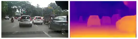

For the first case there's plenty of examples that we can provide. The most intuitive maybe is use of masks in computer vision. Let's say we want to clean an image (i.e. haze removal) as a pre processing step for a self driving car system. Then we could train a model and feed to it not only the image captured by the camera, but also a depth mask estimated using another model. In this case the other model works as a prior distribution, since the model is not learning it, it just leverage that extra information that comes with the image. enter image description here

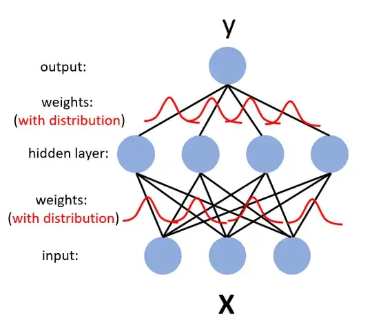

For the second case, there are specific class of models that learn and sometimes require prior distributions as an input, the most known to me are Bayesian Neural Networks. enter image description here
Why bothering providing a prior for these models? Well, there are at least 2 reasons: sometimes we have information about a system we're trying to describe, so we can make the training more efficient, for example we're might trying to fit a coin toss model, but we know the coin is not fair and that the resulting probabilities returned by the model should not be 50/50. The second reason is that sometimes we also want to train models that do not return only raw probabilities, but also estimate the uncertainty level of those probabilities. To do that, the model learns a posterior probability over the data, and it does that by updating an initial prior. Note that the prior for this class of models can also be randomly initialize.
