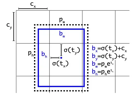

- Offset from the center of the cell ($\sigma(t_x), \sigma(t_y)$ on the image)
- Height and width of the bounding boxes $b_w, b_h$

- YOLO v3 - outputs 9 boxes per pixel from the predefined anchors :
(10×13),(16×30),(33×23),(30×61),(62×45),(59× 119), (116 × 90), (156 × 198), (373 × 326)
These anchors give the priors for the bounding boxes, but with the help of $\sigma(t_x), \sigma(t_y), b_w, b_h$ one can get any possible bounding box on the image for some pixel on the feature map.
