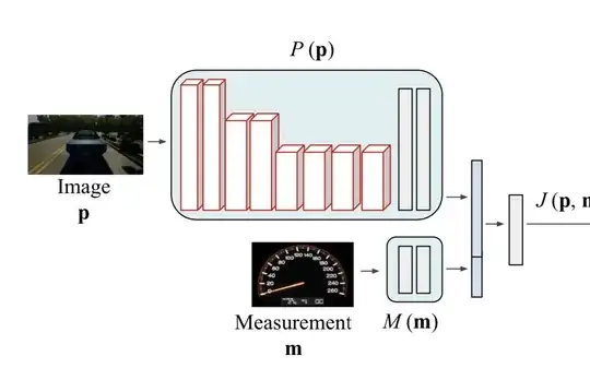

However, a few things confuse me. In a paper the authors want to feed speed measurements into the driving network. Instead of just appending a normalized speed value, they first feed it into several FC layers. Why would they do that? What kind of features could you extract from a single real value? Could there be another reason?
enter image description here enter image description here (p. 3, paper 1)

I would expect the dense layers to be able to detect certain speed ranges. This neuron activates for 0-10, this one for 10-20, this one for 20-30, this one for 20-50, this one for 47.6-89.2...
Of course a later layer could also do that, but it looks like there aren't many layers after this one.
Paper 1-
If I'm understanding the paper correctly, the "Measurements " just represents a collection of auxiliary information. It's not necessarily a single speed measurement, but any auxiliary information, so perhaps gas level, engine temperature, etc. I think them choosing to show a speedometer as a measurement might not be the best choice considering they are predicting the speed value.
