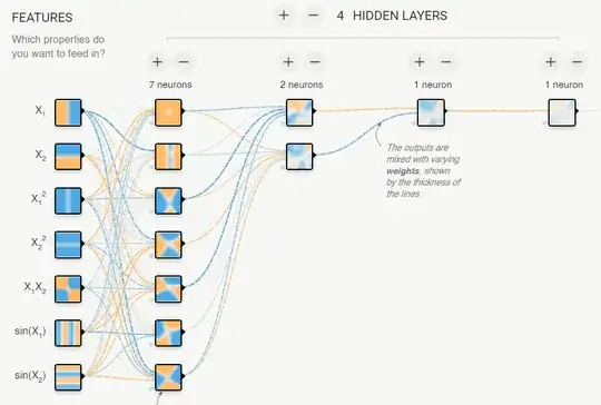

A bottleneck layer is a layer that contains few nodes compared to the previous layers. It can be used to obtain a representation of the input with reduced dimensionality.
If you create bottlenecks in the initial layers it can cause loss of information.
Why it is done?
Take the example of an image dataset that contains high-resolution images. High resolution means more pixels means it will need more nodes in the input layer. Having more nodes will need more computational power to train the network. Hence in such cases, we can use fewer nodes in the next layer. As images are high resolution we might not lose any important information.
Feedforward Network with bottleneck
