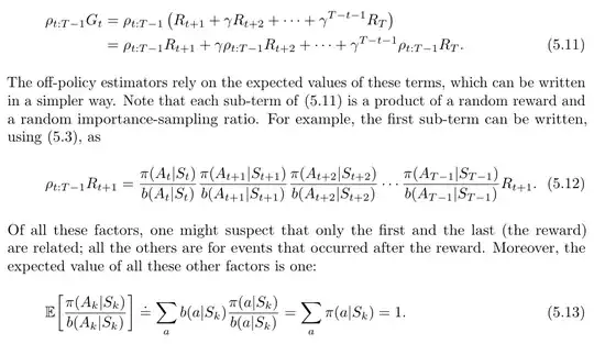

Sutton and Barto explain it themselves in section 5.9. I post it with a bit of context. The equation you're looking for is 5.13.Excerpt from Section 5.9
