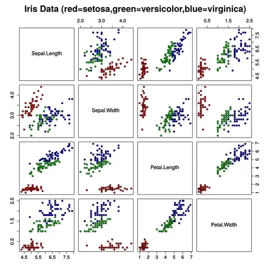

Yes, it absolutely makes sense as the Iris dataset is linearly separable (in the sense that linear decision boundaries are near optimal). This can just about be seen in the scatter plots:
Particularly look at petal width versus petal length, two linear decision boundaries for that pair of variables gives a very low error rate already. This shouldn't be surprising as the dataset was introduced in a paper by Fisher describing his linear discriminant method (about 1936?).
As @htl (+1) rightly points out, a large neural network has way too much capacity for this problem and will likely overfit. However you will probably find that a small neural network fares no better than a linear classifier for this problem.

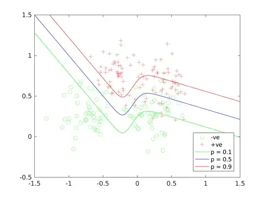

BTW I this case, you might want to try and diagnose the problem by training your neural network on a two-dimensional version of the problem, so that you can plot the decision boundary of the model and see what it is doing. Sepal Width -v- Sepal Length might be a good choice. Experimenting with low dimensional problems that can be directly visualised is often very informative. I Often use Brian Ripley's synthetic dataset in my work because you can easily generate as much data as you could want.
