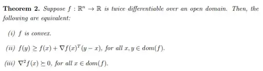

It is the same as other functions. You can use Theorem 2 in this lecture (from Princeton University):
(ii) condition is about the first-order condition for convexity and (iii) is the second-order. You can also find more detail in chapter 3 of this book ("Convex Optimization" by Stephen Boyd and Lieven Vandenberghe).

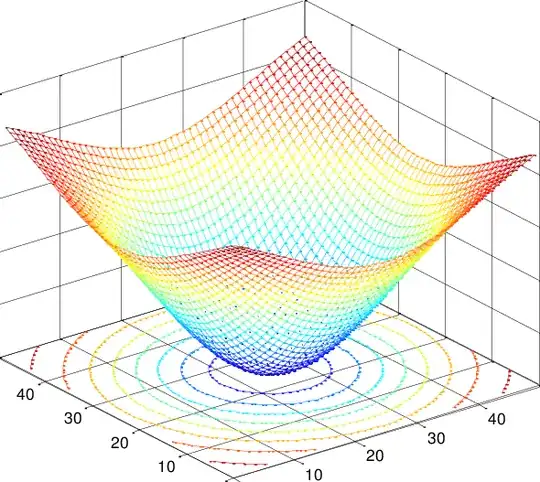

For multidimensional case for any projection on a plane, cutting the loss hypersurface you need to have the same picture as for 1-dimensional case. This is satisfied, provided, that the Hessian matrix is positive definite.

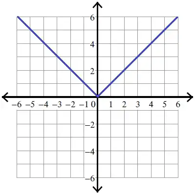

However, for the case of piecewise-linear function, you can imagine something like $|x|$, or a more general function like: $$ f(x) = \begin{cases} \alpha x & \alpha > 0, x > 0 \\ \beta x & \beta < 0, x < 0 \end{cases} $$
If any section of the loss hypersurface in the vicinity of such a singularity has this form - the function will be convex as well.
