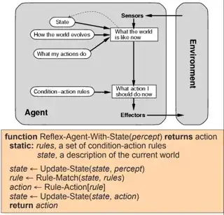

As far as I can understand, this is the internal structure of the agents I want to build:
So the Vehicle Agent can be something like:

For the Vehicle agent's internal state I was considering something like:
