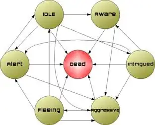

By design, entity's AI can have several mutually exclusive states. enter image description here
This is an existing AI of game, which has states, events and schedules. However, the code is complicated and not flexible. Also, it does not use any cognitive architecture, which I consider as a drawback. https://www.youtube.com/watch?v=9jO-P3kXlCI
Please, using your experience suggest any modern techniques, which can copy such behaviour as in image or video.
