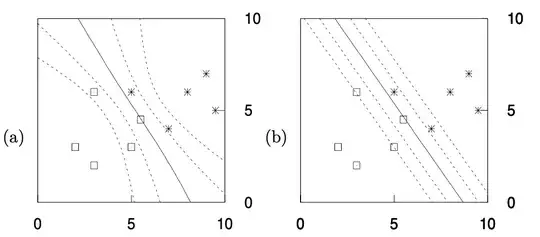

Here I provide the picture from Mackay's book "Information Theory Inference and Learning Algorithms". The model under consideration is single layer neural network with a sigmoid activation function: $$ y(x, \mathbf{w}) = \frac{1}{1 + e^{-(w_0 + w_1 x_1 + w_2 x_2)}} $$
On the left picture, there is a result of Hamiltonian Monte Carlo after a sufficient number of samples, and, on the right, there is an optimal fit.
Integration over the ensemble of models produces a nonlinear separating boundary for NN.
