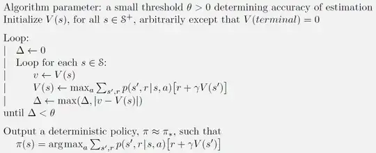

I am referring to the Value Iteration (VI) algorithm as mentioned in Sutton's book below.
Rather than getting the greedy deterministic policy after VI converges, what happens if we try to obtain the greedy policy while looping through the states (i.e. using the argmax equation inside the loop)? Once our $\Delta < \theta$ and we break out of the loop, do we have an optimal policy from the family of optimal policies? Is this a valid thing to do?
I implemented the gambler's problem exercise mentioned in Sutton's book. The policies obtained after using standard VI and the method I described above are mostly similar, yet different for some states.

My understanding is that you want to extend the main update loop like this:
$\qquad V(s) \leftarrow \text{max}_a \sum_{r,s'} p(r,s'|s,a)[r+\gamma V(s')]$ $\qquad \pi(s) \leftarrow \text{argmax}_a \sum_{r,s'} p(r,s'|s,a)[r+\gamma V(s')]$
Where the first line is same as original, the second line is taken from the end update that calculates the optimal policy.
