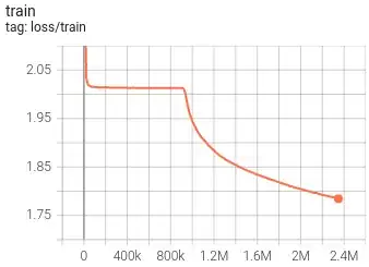

Just for reference this is what happens when there are lots of negative examples:
The AI took a while to figure out that negative samples are not useful (1M steps) in this experiment. From them on it just focused on the positive samples and this training started to converge (and inference started to show something meaningful)
