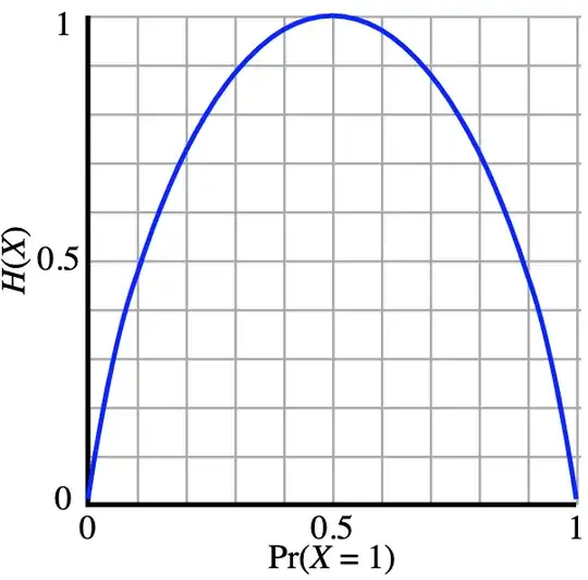

In the case of a Bernoulli random variable (which is a categorical r.v. that can take 2 values, $0$ or $1$, which is a special case of your categorical r.v., if you set $k=2$), then this is the relationship between the probability that this random variable $X = 1$ and the entropy of this r.v.
So, the entropy is $1$ when the probability is $0.5$ and decreases as the probability tends to $0$ or $1$, which makes sense, because the entropy quantifies the uncertainty about the r.v. Here, the entropy is computed in bits because we use the logarithm $\log_2$.
