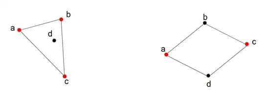

Above we've shown that for a particular set $C$ of $d=4$ points $\text{shatters}(\mathcal{H}, C)$ is false. But we need to prove that it is false for all 4-point sets. To prove this, we consider a convex hull of an arbitrary set of four points $C = \left\{a;b;c;d\right\}$. In general position, the convex hull is either a triangle or a quad:
In the case of a triangle, we choose the outermost three points as a counterexample set $A$. So, with this (labeling) configuration, you cannot find a disk that covers (i.e. classifies) the outermost three points correctly while excluding the point inside the triangle. In the case of a quad, we choose the pair on the longest diagonal. If any three points lay on a single line, then we choose the pair of outermost points.
This sketches a proof that no $d=4$ point set can be shattered by $\mathcal{H}$, but we've shown that there is a $d=3$ set $C'$ that can be. Concluding that $VCdim(\mathcal{H}) = 3$
