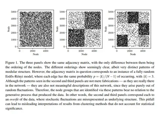

The OP's (i.e. my) assumption is wrong. It is not true that for almost all random graphs under no permutation a pattern is visible, as can be seen in Tiago P. Peixoto's paper Bayesian stochastic blockmodeling, p. 4:
The opposite seems to be correct: For almost all random graphs there are permutations such that patterns are visible.

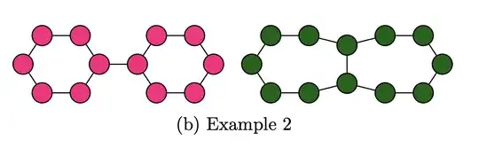

But GCN's power is limited by what's called the 1-WL test. More plainly, GCNs can fail to distiniguish two non-isomorphic graphs. For example, imagine two non-isomorphic graphs that are locally the same!
Source
So in your case, you have a bunch of graphs but only two isomorphism classes - a GNN will definitely return the same output for graphs within the same class (because locally, and also globally but that isn't relevant, they are the same). Whether they can distinguish between the classes depends on the examples themselves.
