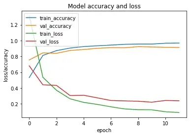

I am trying to train my model to classify 10 classes of hand gestures but I don't get why am I getting validation accuracy approx. double than training accuracy.

I am getting accuracy like:
Epoch 1/20
118/118 [==============================] - 117s 620ms/step - loss: 2.4571 - accuracy: 0.1020 - val_loss: 2.2566 - val_accuracy: 0.1640
Epoch 2/20
118/118 [==============================] - 70s 589ms/step - loss: 2.3253 - accuracy: 0.1324 - val_loss: 2.1569 - val_accuracy: 0.2512
I have tried removing the Dropout layer, changing train_test_split, but nothing works.
EDIT:
On changing the dataset to color images from https://www.kaggle.com/vbookshelf/v2-plant-seedlings-dataset , I am still getting higher validation accuracy in initial epochs, is it acceptable or I am doing something wrong?
