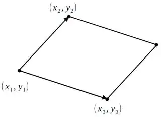

Let's assume that we want to learn the areas of parallelograms built on pairs of vectors:enter image description here
The input data are six coordinates: $(x_1, y_1, x_2, y_2, x_3, y_3)$.

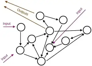

It will initialize a network with random activation functions in neurons, and random connections between them having random weights. It also randomly assigns some neurons as inputs, while other outputs or internal ones.
Then I train my network
wonder_network.fit(x_tr, y_tr, use_wand=True)

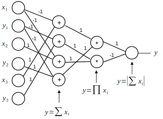

During training, the activation functions inside neurons change, the connections between neurons form, disappear, and form again, and their weights are adjusted. Some neurons organize in layers, the number of neurons in each layer changes, and finally the trained network is as follows:
It solves the task with 100% accuracy for both the training and test data, and it solves it using only raw data: coordinates. No need to engineer features.
