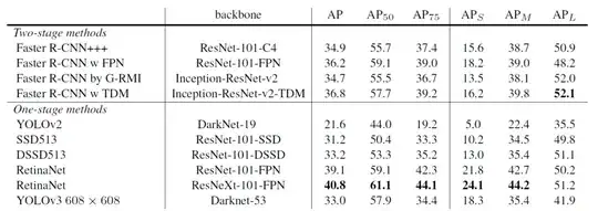

Precision for Small Objects:
The chart below (taken and modified from the YOLOv3 paper) shows the average precision (AP) of detecting small, medium, and large images with various algorithms and backbones. The higher the AP, the more accurate it is for that variable.
YOLOv3 comparison for different object sizes showing the average precision (AP) for AP-S (small object size), AP-M (medium object size), AP-L (large object size)
Read more at: https://viso.ai/deep-learning/yolov3-overview/
Source: Focal Loss for Dense Object Detection
YOLOv3 increased the AP for small objects by 13.3, which is a massive advance from YOLOv2. However, the average precision (AP) for all objects (small, medium, large) is still less than RetinaNet.

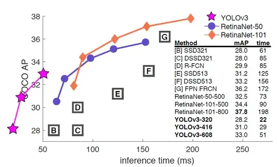

Speed:
YOLOv3 is fast and accurate in terms of mean average precision (mAP) and intersection over union (IOU) values as well. It runs significantly faster than other detection methods with comparable performance (hence the name – You only look once). Moreover, you can easily trade off between speed and accuracy simply by changing the model’s size, without the need for model retraining.
Speed comparison between RetinaNet50 vs YOLOv3
