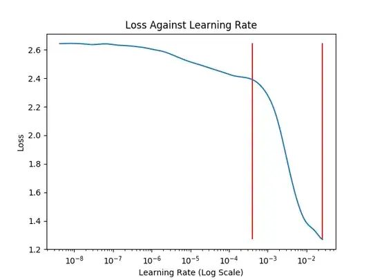

Here is a concrete example from one of my experiments:
Learning Rate Finder Loss Plot
In this case, I start my learning rate search at 1e-09 and plan to end with a learning rate of 0.99 (although I am actually able to stop sooner than that). Your experiment may require different search bounds, but you could always start with that and adjust things as needed. At first, the loss plot is flat, and then it begins to decrease, but is too gradual. At the first red line, loss starts to decrease sharply, and once it reaches the second red line, the plot has begun to level off, so I can end my search. For this particular experiment, my ideal learning rate range had a minimum of 4.01e-4 and a maximum of 2.58e-2.
For more information, I suggest reading this Keras Learning Rate Finder post, which contains more information on how the process works and a tutorial for how to program it using Keras and Tensorflow.
