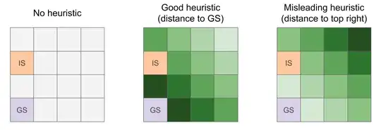

There is an inherent assumption in heuristic search that the heuristic function points you in the right direction.
A* largely depends on how good the heuristic function is. Two nice properties for the heuristic function are for it to be admissible and consistent. If the latter stands, I can't think of any case where BFS would outperform A*. However, this property doesn't stand in every case.
If you select a misleading heuristic function (i.e. a function that points you in the wrong direction) then BFS should outperform A*.
I drew a dumb example to illustrate my point. You want to reach from the Initial State (IS) to the Goal State (GS). The shade of green indicates the value of the heuristic (the greener the better).
In the third case, where you have a misleading heuristic, A* would tend to explore areas near the top right first, then it would go down towards the GS. This case is actually worse than having no heuristic and using a BFS.
