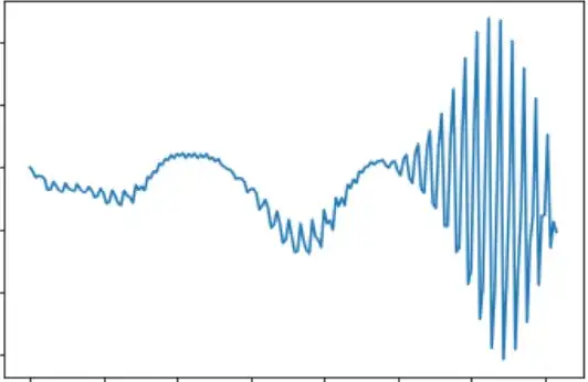

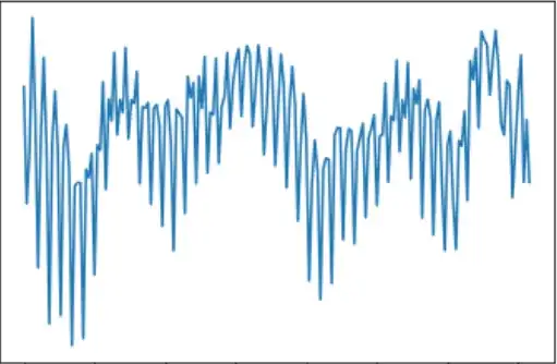

I am training a Semi-Supervised GAN, using multivariate time-series with window of shape (180*80) with the generator and discriminator architecture below. My data is scaled using Robust Scaler, so I kept linear activation for the generator output.
During the training I get noise in the generated signals and I can't understand the reason why whereas the original data is smooth. What can be the reason for this noise?
A generated signal.Another generated signal.

Sorry cannot directly reply to your comment as I posted without an account, and you were right! I replaced transposed layers with Upscale1D+Conv1D and that solved the issue.
gen = Conv1DTranspose(128, 4, strides=2, padding='same', kernel_initializer=w_init, use_bias=None)(gen)
should become (notice that strides=2 becomes strides=1):
gen = Upscale1D()(gen)
gen = Conv1D(128, 4, strides=1, padding='same', kernel_initializer=w_init, use_bias=None)(gen)
