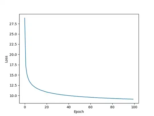

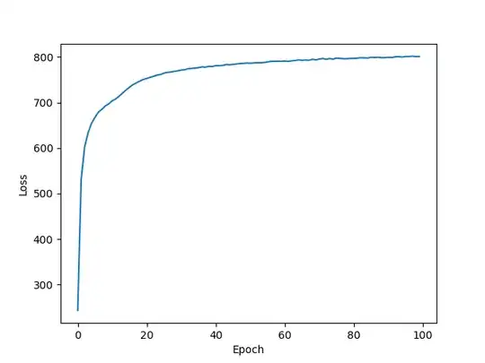

Edit 1: Below are my loss plots with 0,1 distribution. Reconstruction: reconst-loss
Divergence: enter image description here
Generation samples: enter image description here
Reconstruction samples (left is input, right is output): enter image description here

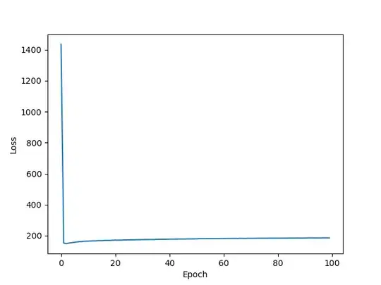

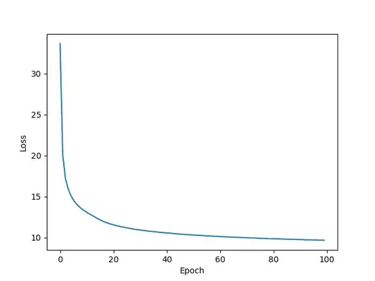

And here are the plots for 10,1 normal distribution.
Reconstruction: enter image description here
Generation sample: enter image description here
Note: when I ran it this time, it actually seemed to learn the generation a bit, though it's still printing mostly 8's or things that are nearly an 8 by structure. This is not the case for the standard normal distribution. The only difference from last run is the random seed.
Reconstruction sample: enter image description here
