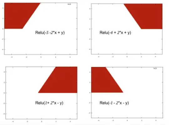

Neural networks excel at a variety of tasks, but to get an understanding of exactly why, it may be easier to take a particular task like classification and dive deeper.
In simple terms, machine learning techniques learn a function to predict which class a particular input belongs to, depending on past examples. What sets neural nets apart is their ability to construct these functions that can explain even complex patterns in the data. The heart of a neural network is an activation function like Relu, which allows it to draw some basic classification boundaries like: Example classification boundaries for Relu
By composing hundreds of such Relus together, neural networks can create arbitrarily complex classification boundaries, for example:enter image description here
