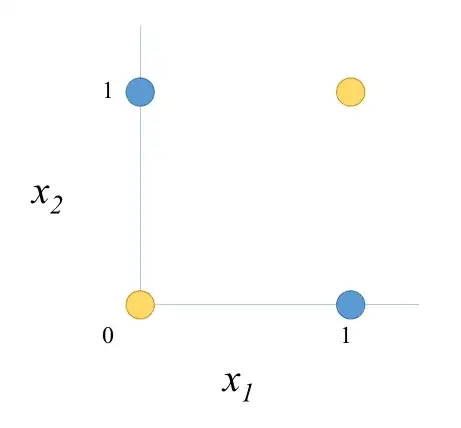

Can someone explain to me with a proof or example why you can't linearly separate XOR (and therefore need a neural network, the context I'm looking at it in)?
I understand why it's not linearly separable if you draw it graphically (e.g. here), but I can't seem to find a formal proof somewhere, I wanted to try and understand it with either an equation or example written down. I'm wondering if one exists (I guess it has to do with contradictions?), but I can't seem to find it? I have seen this, but it's more a reason than a proof.

Consider these 4 points that represent a XOR table. Let us label them clock-wise, so the top-left point as $A$, top-right point as $B$, bottom-right point as $C$, and bottom-left point as $D$. So $A$ and $C$ have the same label, and $B$ and $D$ have the same label. We want to show that points $A, B, C$ and $D$ cannot be linearly separable.
Assume the contradiction, and that there is a line that can separate these 4 points.
Imagine a fifth point that lies in the center, and let us label this as point $E$.
Since $E$ lies in the center, the three points $A, E$ and $C$ are collinear. Similarly, since $E$ lies in the center, the three points $B, E$ and $D$ are collinear.
Because we assume a line can linearly separate $A, B, C$ and $D$, then this line must label point $E$ as some label. If $E$ shares the same label as $A$ and $C$, then the points $B, E$ and $D$ will become "collinear points where the middle point has a different label", which by Lemma 1 cannot be linearly separable. Likewise, if $E$ shares the same label as $B$ and $D$, then the points $A, E$ and $C$ will become "collinear points where the middle point has a different label", which by Lemma 1 cannot be linearly separable.
Therefore it is impossible to give a label to $E$ while satisfying linear separability. As a result, our assumption must be false, and the four points $A, B, C$ and $D$ cannot be linearly separable.
