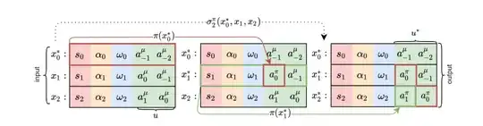

4. Partial Trajectory resampling (PTR)
A method that recursively resamples actions in the buffer, replacing them with on-policy actions. It uses the delay dynamics to simulate their effect on the current policy.
If random delays exist on an MDP, some actions present in the off-policy replay buffer will not influence the later delayed observations and rewards, for a number of timesteps. This will allow generation of on-policy sub-trajectories from the off-policy samples by recursively resampling the most recent actions from the action buffer. It will not invalidate the sub-trajectory.
The resampled action will be valid as long as the observation delay $\omega$ and the action delay $\alpha$ are both greater than the current time step $t$ i.e., No delayed observation depends on a resampled action.
$$ \omega_t + \alpha_t >= t $$
Partial trajectory resampling Illustration of PTR, (3)

RL with random delays (2020)[3] describes and applies Partial Trajectory Resampling in RL. It's the only work I've managed to come across that handles both random and constant delayed MDPs.
