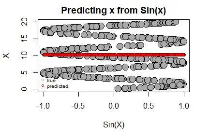

I made a simple feedforward neural network (FFNN) to predict $x$ from $\sin(x)$. It failed. Does it mean the model has overfitted? Why doesn't it work?
set.seed(1234567890)
Var3 <- runif(500, 0, 20)
mydata3 <- data.frame(Sin=sin(Var3),Var=Var3)
winit <- runif(5500, -1, 1)
#hidUnit <- c(9,1)
nn3 <-neuralnet(formula = Var~Sin,data = mydata3,
                hidden =c(4,2,1),startweights =winit,
              learningrate = 0.01,act.fct = "tanh")
plot(mydata3, cex=2,main='Predicting x from Sin(x)', pch = 21,bg="darkgrey", ylab="X",xlab="Sin(X)") points(mydata3[,1],predict(nn3,mydata3), col="darkred", cex=1,pch=21,bg="red")
legend("bottomleft", legend=c("true","predicted"), pch=c(21,21), col = c("darkgrey","red"),cex = 0.65,bty = "n")

The labels are not unique for the input domain [0,20]. Think about sin(x)=0, x could be 0, pi, 2*pi, 3*pi, ..., n*pi, all are correct from a mathematical point of view, but this is not reflected in your MSE loss. At this point your NN has to guess the correct label from your input data. Predicting the mean of your input data is the safest bet for the network.
In essence you're trying to build a arcsin function with a NN. If only consider x values in [-0.5*pi,0.5*pi], the labels are unique and your network should work.
