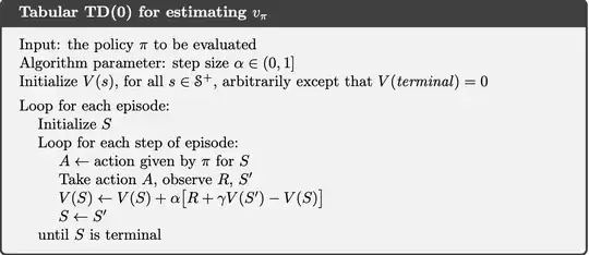

The only way I am getting the optimal policy is when I am updating the policy in each iteration and then following the updated policy when calculating the TD target. But according to the algorithm from Sutton and Barto a given policy (which is fixed over all episodes - see line 1 below) should be evaluated. TD0FromSuttonAndBarto

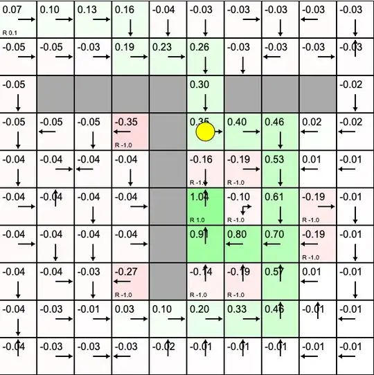

where (n, w, s, e) = (north, west, south, east). According to the result from Andrey Kaparthys simulation (from here) the final policy should look like this
ReinforceJSResult

  1. The value function has to converge. Meaning my policy should be the same as on the website (picture 2)?
  2. Only the value of my final state is positive while on the website simulation the whole optimal trajectory has positive values. I know that this is because on the website they update the policy in every step. But shouldn't it also work without updating it iteratively like I did it?
  3. Since I am taking a random action (from n,w,s,e) in every step in every episode for example state [6, 5] or [6, 6] (the one below the terminal state) can not really take advantage of the positivity of the terminal state since they are surrounded by more negative-reward-states than this positive-reward-state. This is why after so many iterations the values are getting negative.
