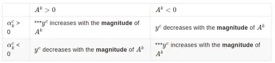

To address a comment further down, this table explains why I'm thinking about magnitude rather than sign of the activations.
It comes from thinking about the possible variations of
$$ L_{Grad-CAM}^c = ReLU\bigl( \sum_k \alpha_k^c A^k \bigr) $$
